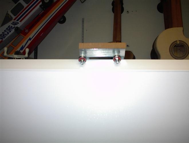

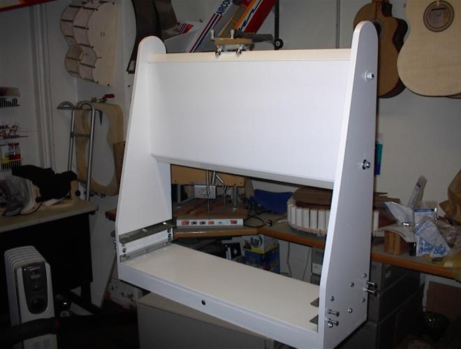

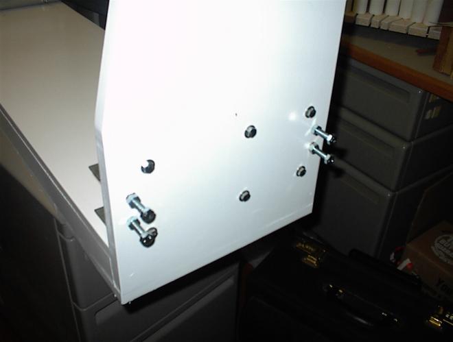

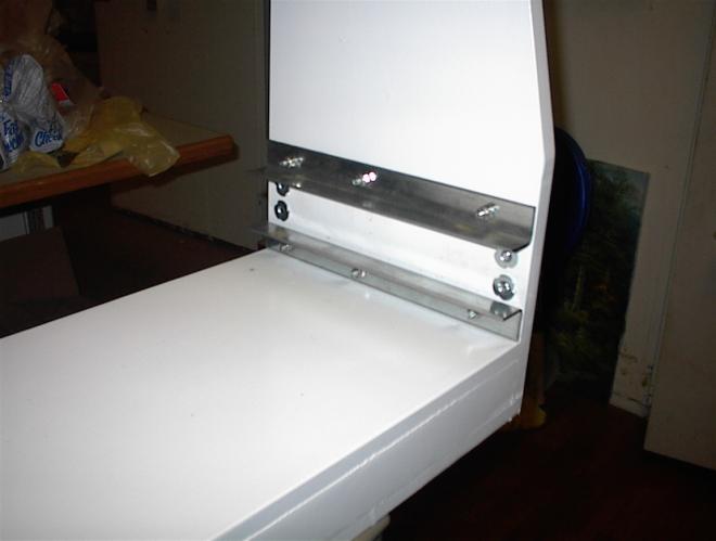

Here are some more pictures.
Here is a close-up of the x axis adjustable rail supports.
PostPosted: Thu Nov 10, 2005 4:19 pm
Posts: 299

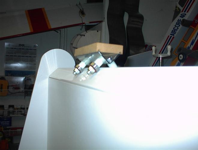

Adjustment bolts.
Mock-up of y axis skate bearing slide.
Bearing rolling on rail (Very Smooooth!!)

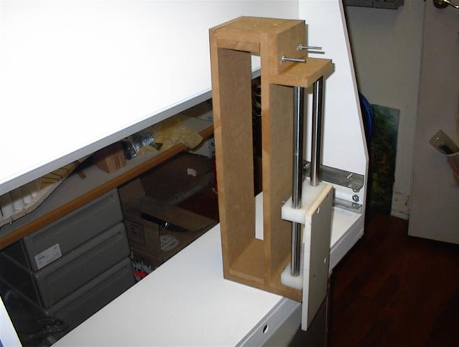

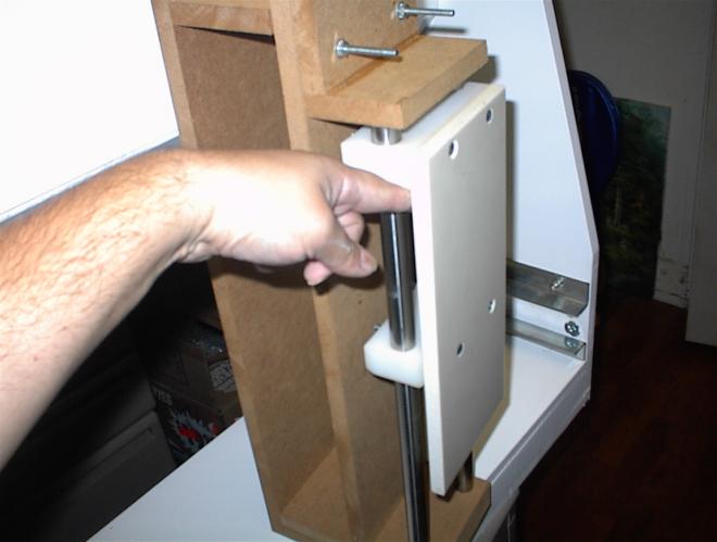

Here is a couple pictures of the incomplete z axis.
I'm currently working on the table, I should have it complete within a few days. The price has gone up becuase I decided to go with much larger 640oz steppers and Gecko g202 drivers. this upgrade cost about $400 more.
So far with everything purchased including Mach3 software I'm right at about $1000.00 As I said, this could still be done using the xylotex controller and 269oz steppers for about $400 less. The stepper I am using are stronger than those found on the shopbot.

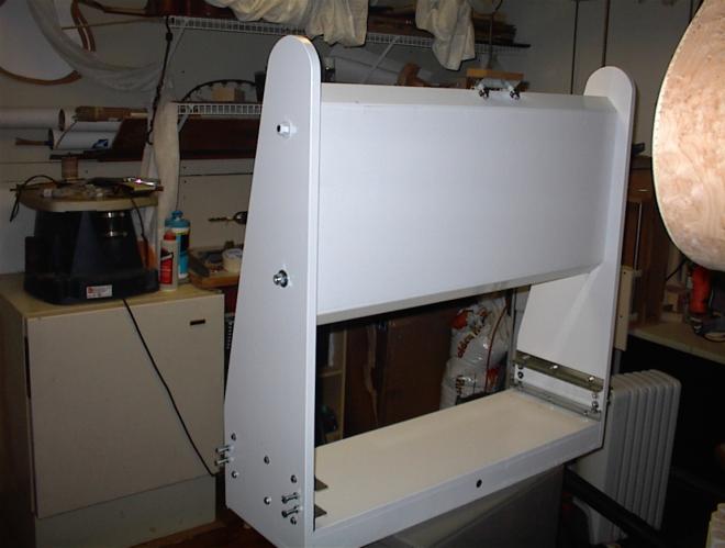

Hi guys, I just wanted to let you know that I just finished buiding the table, whew! what a job! I built it using 3/4" extira for the bed and torsion box ribs and I used 1/2" ply underneath. I decided to test it's strength and deflection so I enlisted the help of my 15yr old daughter and there was no deflection what so ever! My daughter pretty petite so I decided to go for broke and give it the ultimate test, all 315lbs of me and the deflection was almost unnoticable! I'll post more pictures after I pretty it up a bit with paint.
